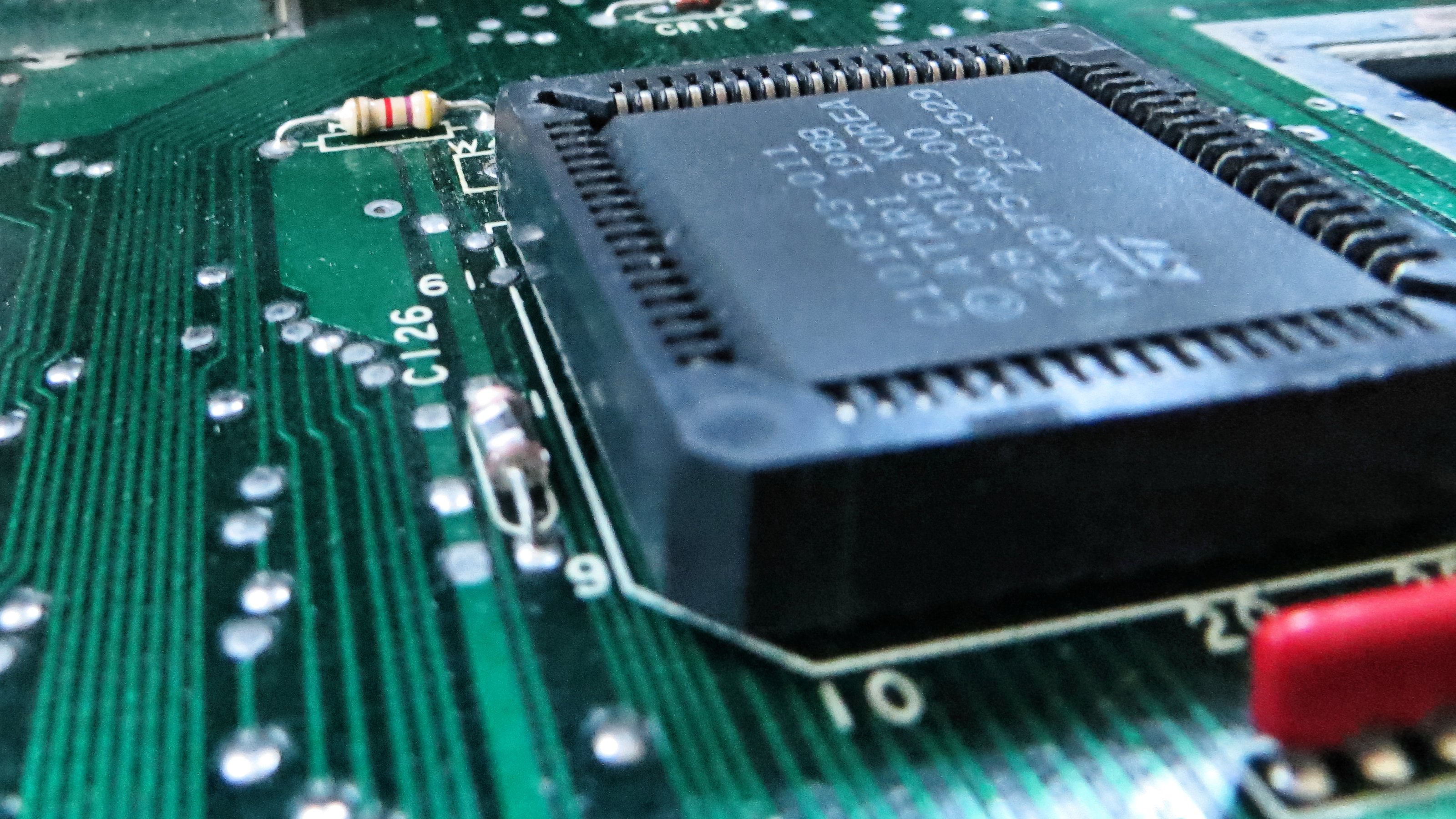

Sent you a picture of my strange 1040STE-Blitter.
I found another, very similar one in my IC drawer. It's an ST, too. Just three weeks younger (8945) and the Z-Number on the bottom right is different (Z927190). I am very sure that I removed it from a MegaST and not a STE.
I do have two MM9092V (NS?) and two C101643-31 with different printing on top and a C101643-011 (1987).
Do you expect different results of the same Blitter if put in a MST or STE?

Sent you a picture of my STE's blitter. My test returned number 0040.

Arne wrote: Wed Feb 17, 2021 7:54 pm Sent you a picture of my strange 1040STE-Blitter.
I am interested in that picture, too.

Probably the same as your No.2 setting. It a ST brand one. I am sure ijor will clarify things.

ijor wrote: Wed Feb 17, 2021 8:23 pm By ST you mean the Signetics/Thompsonlogo? C101643-011?
"ST" as in "SGS-Thomson" (not Signetics). But, yes, C101643-011. Photo is here: https://www.chzsoft.de/asic-web/images/header.jpg (as it's used as banner in my article about recovering the ASIC schematics).

ijor wrote: Thu Feb 18, 2021 1:54 am Specifically I wanted to know if the SGS version is an earlier part (it seems so)? May be the first version of Blitter? Though you might have some idea.
A while ago, I had collected photos of Blitter chips for my list of ASIC manufacturers contracted by Atari. The oldest one (datecode 8809) is this image from Wikipedia: https://en.m.wikipedia.org/wiki/File:Atari_Blitter.jpg. It has the logo of "Innovative Silicon Technology" that according to my research was "a wholly owned subsidiary of SGS." Thus, I find it likely (but have no proof) that ST's (SGS Thomson's) Blitter is indeed an early design.
