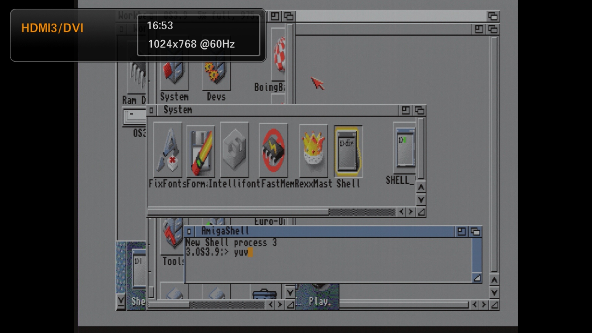

Quick update to say the disable_scandoubler option of the AGA core worked like a charm. No more pink screen. :D
I noticed one quirk in the core though: it always starts in "scandoubled" 50hz then switches to whichever mode is configured. This can screw up the upscaler, but you can fix it by rebooting the upscaler to pick up the new resolution.

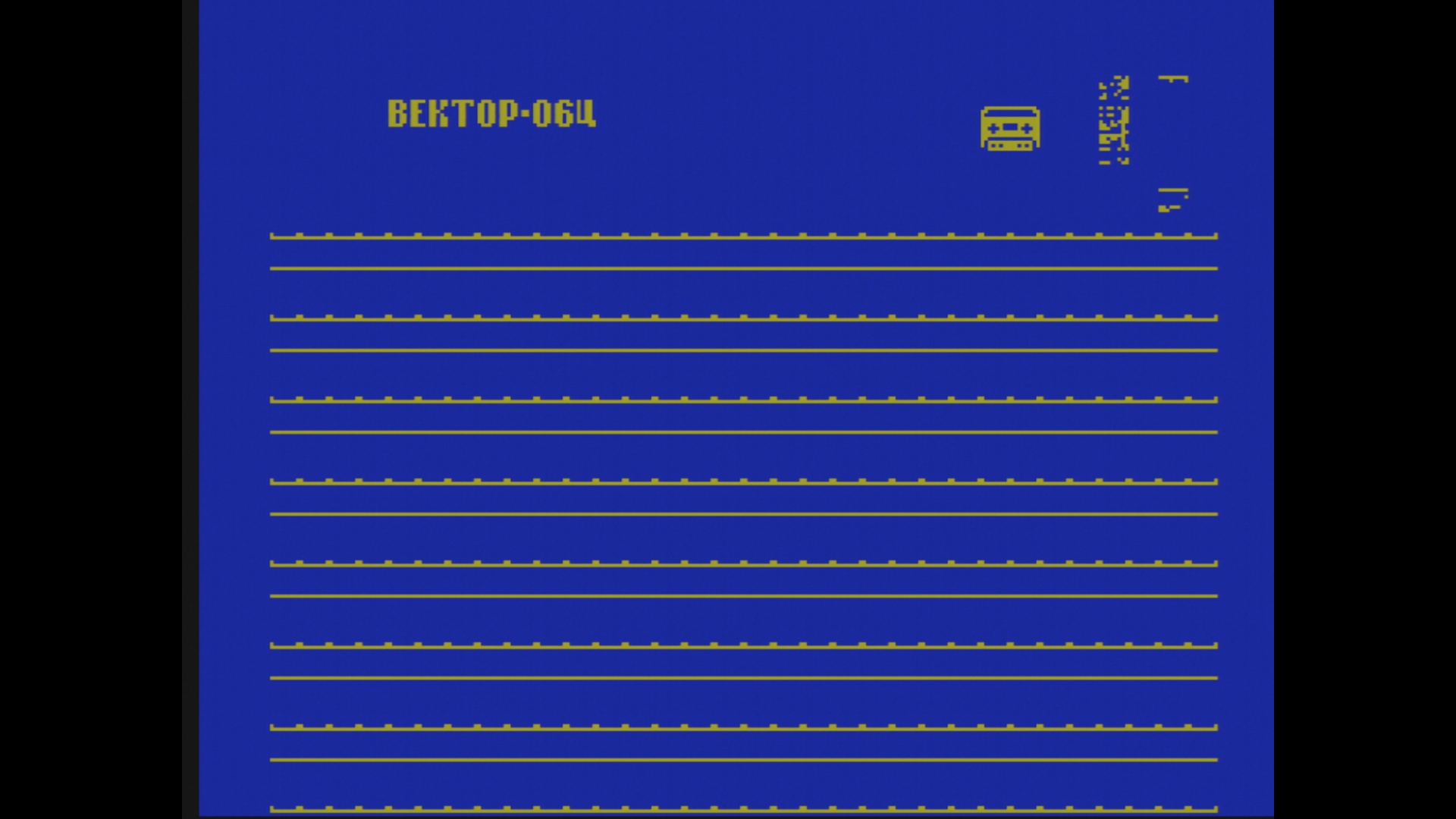

Postby Newsdee » Tue Feb 17, 2015 4:13 pm
WOW!! The Gonbes turns out to work quite nicely!
It doesn't work with scandoubler disabled (expects 480p on RGBHV) and not all cores work (some show an image off centre),
but it has one big advantage: it solves the scaling issues seen on many TVs / screens at a very tiny cost compared to the XRGB!
Updated the wiki and the Core status sheets to show compatibility with upscalers.
Direct capture with an X-Capture1, notice the P and g in "Page" at the bottom right:
Adding a Gonbes PCB in the middle, slightly fuzzier image but larger resolution and better scaling:
