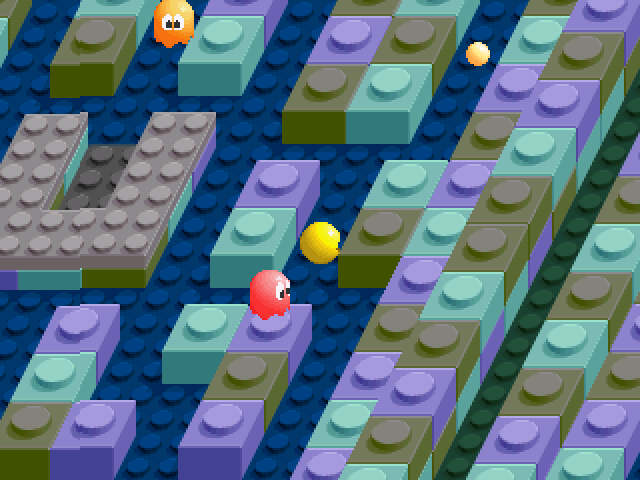

Hello guys,
here is a PacMania VGA version for you to play around with.
Be warned: it's only a test and runs on 320x240 VGA only! It's slow and still no pills visible. You can use Hatari to check it out as well.
It's playable though (press trigger or left shift to play, use arrows or stick to move). Have fun to find all the invisible pills! ;)
Press "R" once if the playfield looks scrabled to rebuild it. Press "ESC" to quit the program.
Please let me know how this runs on accelerated Falcons (if it runs at all).
[Edit:]Hatari screenshot:
Download: PacMania VGA Test
Sascha

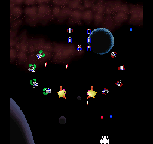

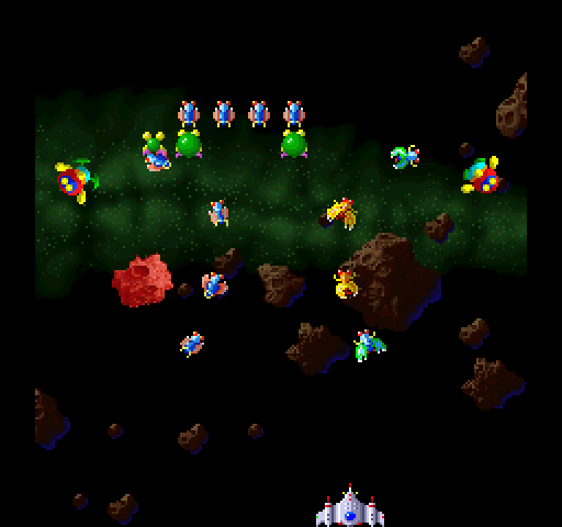

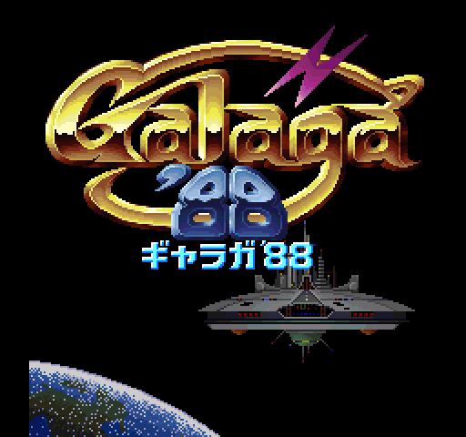

Postby Anima » Sun Nov 11, 2012 12:30 pm
Hello guys,
short update to the Galaga 88 port WIP:
It runs on the Falcon. 256 x 240 pixels screen. No text layer yet. Framerate on 16 MHz fluctuating between perfect and totally awkward. And the best: it's already playable, better than PacMania since no extra layer is needed for the gameplay! :)
Still many things to iron out.
Just take a look at these Hatari screenshots:
Sascha
