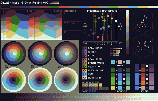

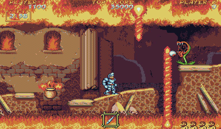

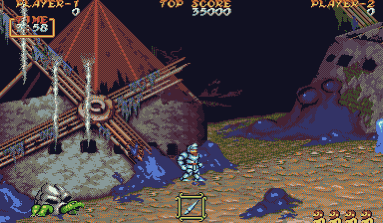

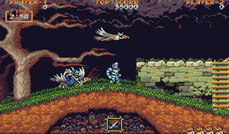

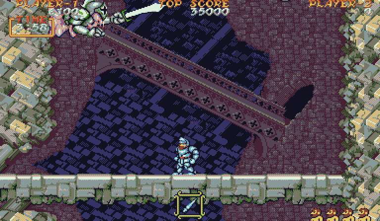

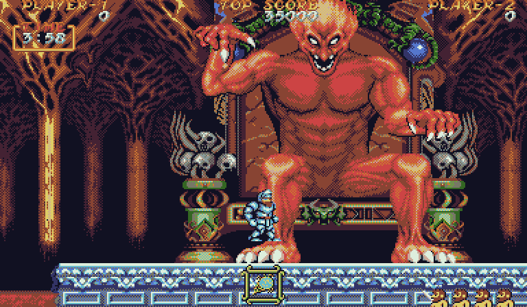

Postby Anima » Fri May 19, 2017 11:38 pm
chlu600 wrote:It'll be hard anyway to create an optimal 16-color palete for only one level and it's sprites.
Yes indeed. I think I've found a good one. Actually it's the "DawnBringers 16 colours palette":
Here are some remapped MAME screenshots using the palette:
dml wrote:Great progress - this looks amazing!
Thanks Doug! I hope that I can squeeze everything into the 4 MB of the STE.

That's an impressive universal palette (DawnBringer). I notice it doesn't match STE rgb bitdepth as the values use all 8 bits of R,G,B where the STE has only 4 bits. Did you have to edit the values further or did you just let it quantise down to 4? I guess quantising would be enough since its already very well distributed.
And have you considered interlacing this palette to get it up to 5 effective bits? If you alternate every 2nd palette index (high/low on alternate fields) it should keep the flicker minimal, unless one colour dominates at any time - but that's about the best you can do without requiring more gfx of course.
Anyway this looks cool - the palette really works with the art!
