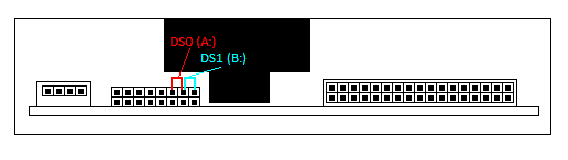

Pinout for selecting SMD-380 as DS0/DS1 is as follows:

I tried you method Tzok, it did not work for me. changing the jumper on the FDD did nothing. Sorry I followed your post and it did not work for me on my Mega STE.
you say if one drive is internal.. then pin 6 should always be grounded. SO you are says W401 - AS LONG AS THERE IS AN INTERNAL DRIVE.. should stay in the 2-3 position.. and only W402 should switch.
This still does not prevent the internal drive from receiving the D0sel when I want to use the external drive as D0sel my observations show that I am running the internal drive the same time.. with a Gotek this is bad.. because it is not a std drive with 40/80 tracks etc.. the first time this happened to me it tried to run the head right off the rails.
