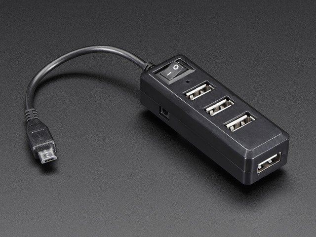

I've ordrered a (third) USB otg like this one: Image

I have that exact USB hub pictured, but also a power adapter for it. I have connected a Sega Saturn SLS USB pad, wifi dongle and dongle for the Logitech K400 keyboard and it works just fine :)

Shaneus wrote:I have that exact USB hub pictured, but also a power adapter for it. I have connected a Sega Saturn SLS USB pad, wifi dongle and dongle for the Logitech K400 keyboard and it works just fine :)
Nice, it should arrive to my mailbox tommorow.
On ebay's description of this hub, it is written:
There is a 1.7mm port for an external power supply but its connected directly to the 5V line so if you need to externally power, we recommend prying open the case and cutting the red 5V line from the USB connection.
Is this really necessary?
I think it is, because I think that if you don't, power can feed back into the MISTer (which we don't want, we only want the USB devices getting power).
You might not need to, but if it's a $10 hub vs a $150 FPGA I'm definitely not going to risk it. I did with mine and it was easy.

Bouboule69 wrote:...
This is really a bad design especially having a power switch on the HUB they could have wired it like this:
Power Off -> Hub powered via the host.
Power On -> Hub powered via the external power supply.
If you power it via external power supply cut the red wire as instructed.
