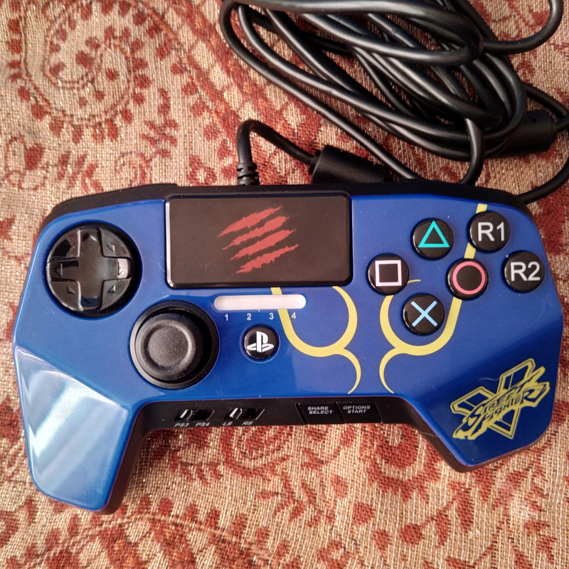

Postby MinPin » Sun Feb 16, 2020 3:35 pm
Hi
I bought these controllers. They were $10 each on special at an online store. They work very well on MiSTer.
Imagepicture url
Sorgelig
Posts: 6056
Joined: Mon Dec 14, 2015 10:51 am
Location: Russia/Taiwan
Re: Joystick testing thread
Postby Sorgelig » Sun Feb 16, 2020 5:03 pm
MinPin wrote:Hi
Imagepicture url
Interesting joystick. SNES+Genesis layout mix. Is there a link for this?
