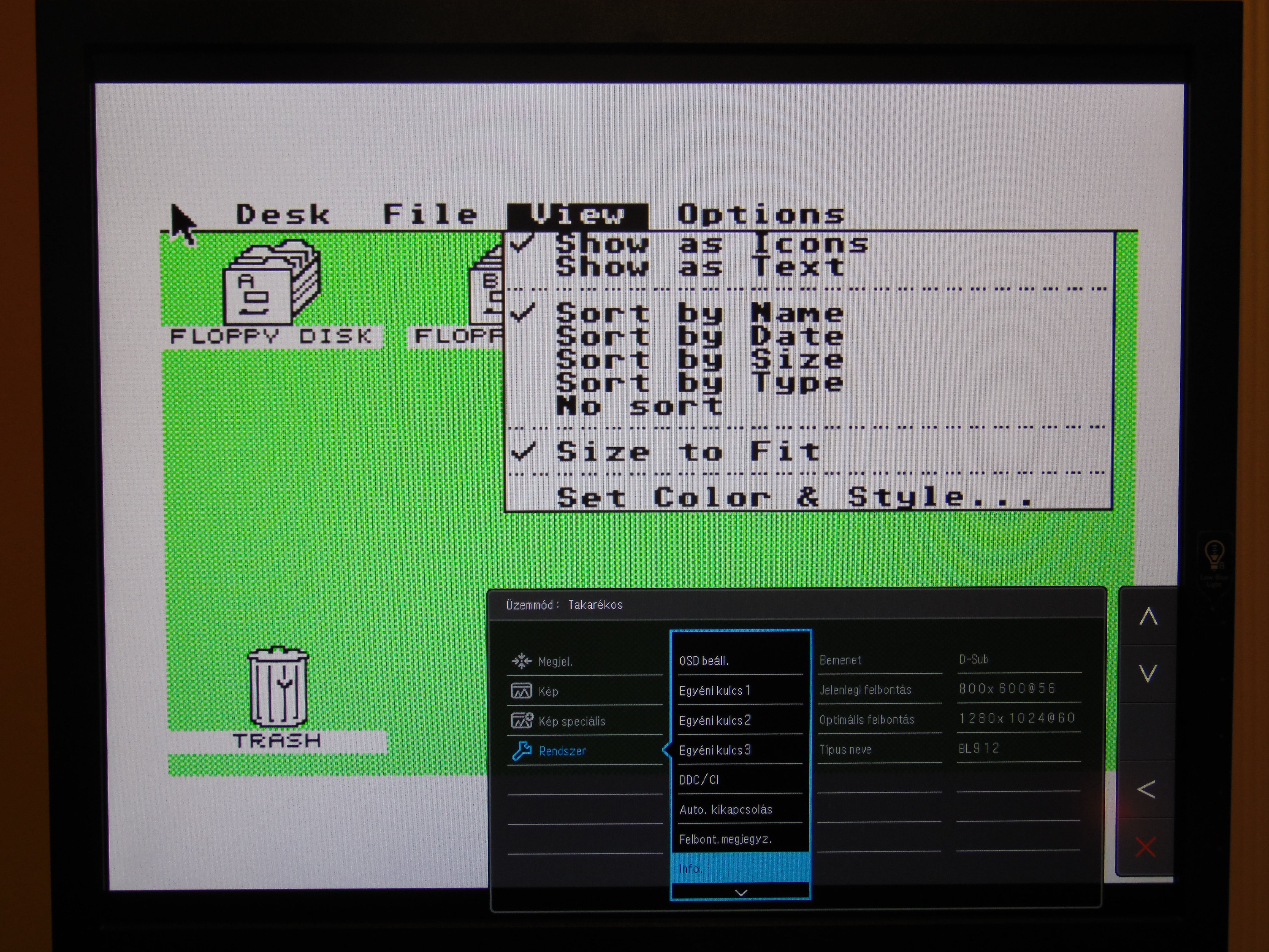

I just got an ST mini (mist clone) and I'm a bit disappointed by the video output too ..
I was hoping to get a pixel perfect output but I get scaling which is ugly.
I tried the latest firmware and latest ST core on 4 different VGA monitor, on my Sony TV it says that the video signal is wrong, and on my 3 others VGA monitor I get ugly scaling, 2 are 16:9 (Viewsonic 2231wa, Viewsonic 2014w) and the last one is 5:4 (Acer V176L bm)
PAL 56 or 50 mode won't change anything to the scaling ugliness.
Would I need something like a Multisync capable lcd monitor to get accurate "pixel perfect" output ?
do you recommand any specific model ?
Or is preferable to get an RGB scart cable to get accurate video on a real TV ?

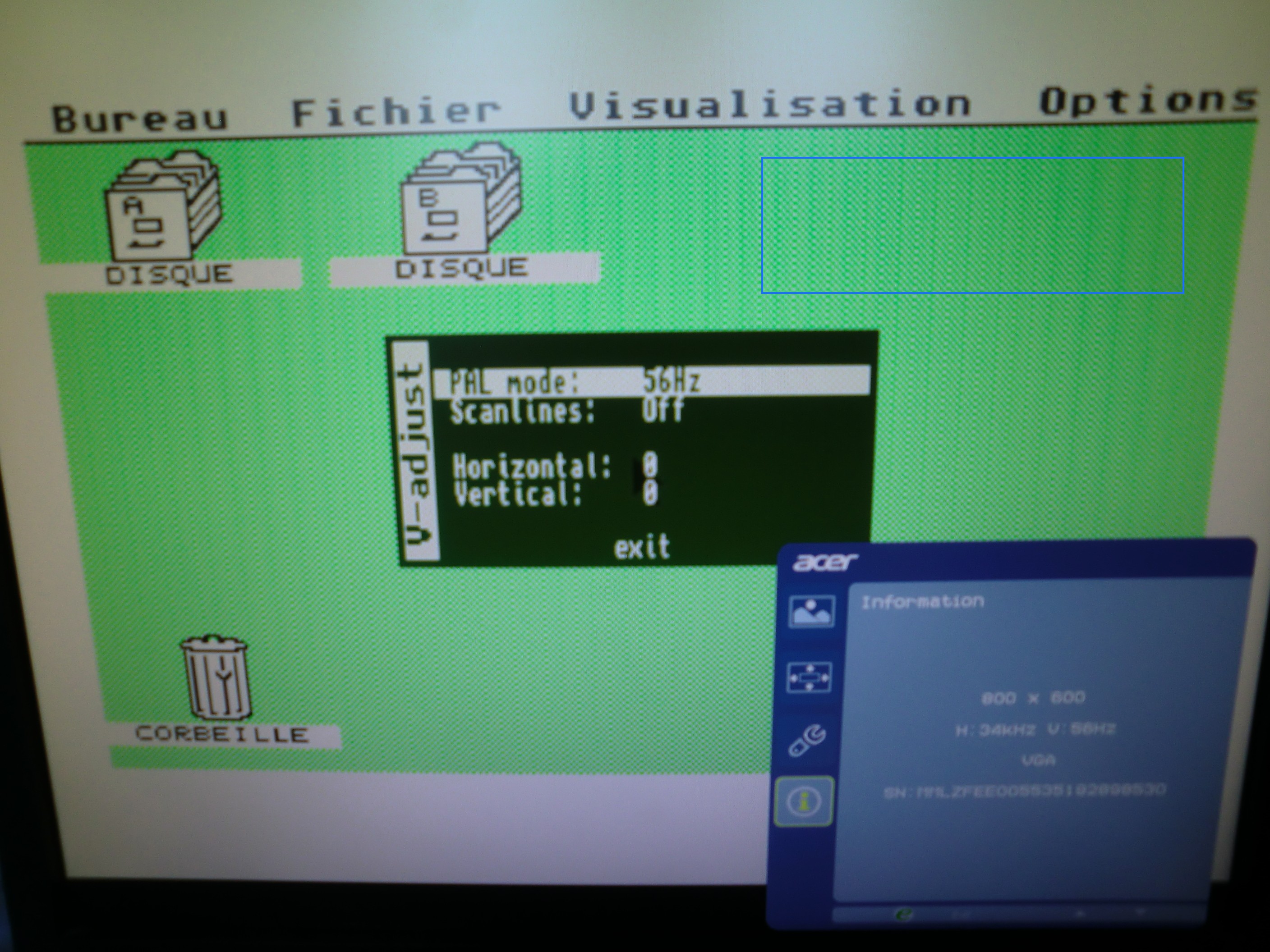

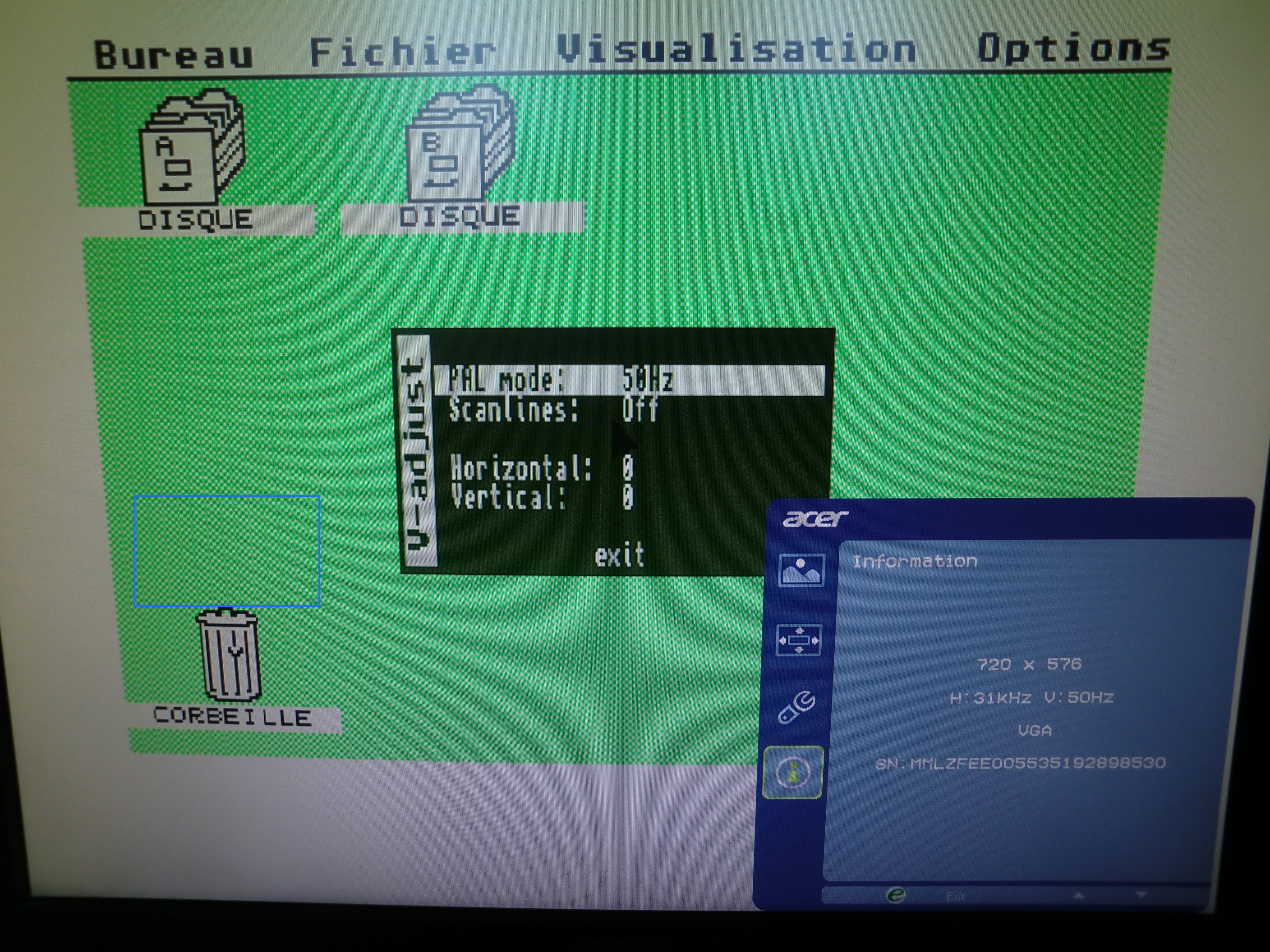

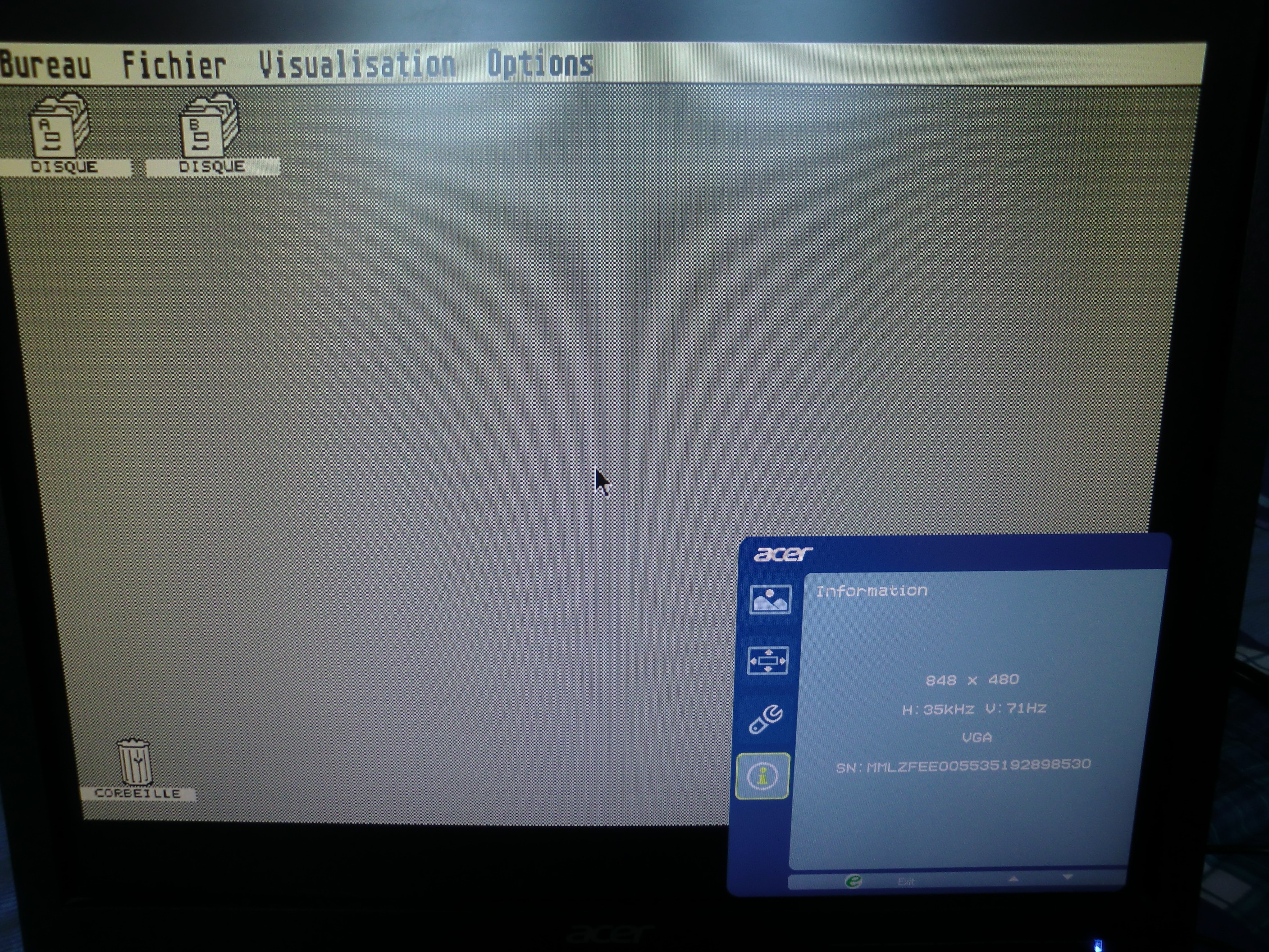

I don't quite understand, I see that, most of cores says "PAL mode is 720x576p @50hz"
that is 5:4 resolution, then why I have bad scaling on my 5:4 monitor ?
does the Atari ST video core use this video mode too ?
the other core such as the C64 and PlusToo are working great without much scaling issue.
I guess the Amiga one also works (didn't tried to much that one)
Here is a closeup photo of each video mode I tried, this is the best result I can get, even when tweaking the monitor horizontal position/clock/focus
PAL 50hz
PAL 56hz
mono
I got the 1280x1024 highrez mode working but only with manual monitor horizontal tweaking, which I must do each time, this is annoying
any good VGA monitor that someone can recommand for the mist that can get the MiST resolution pixel perfect ?

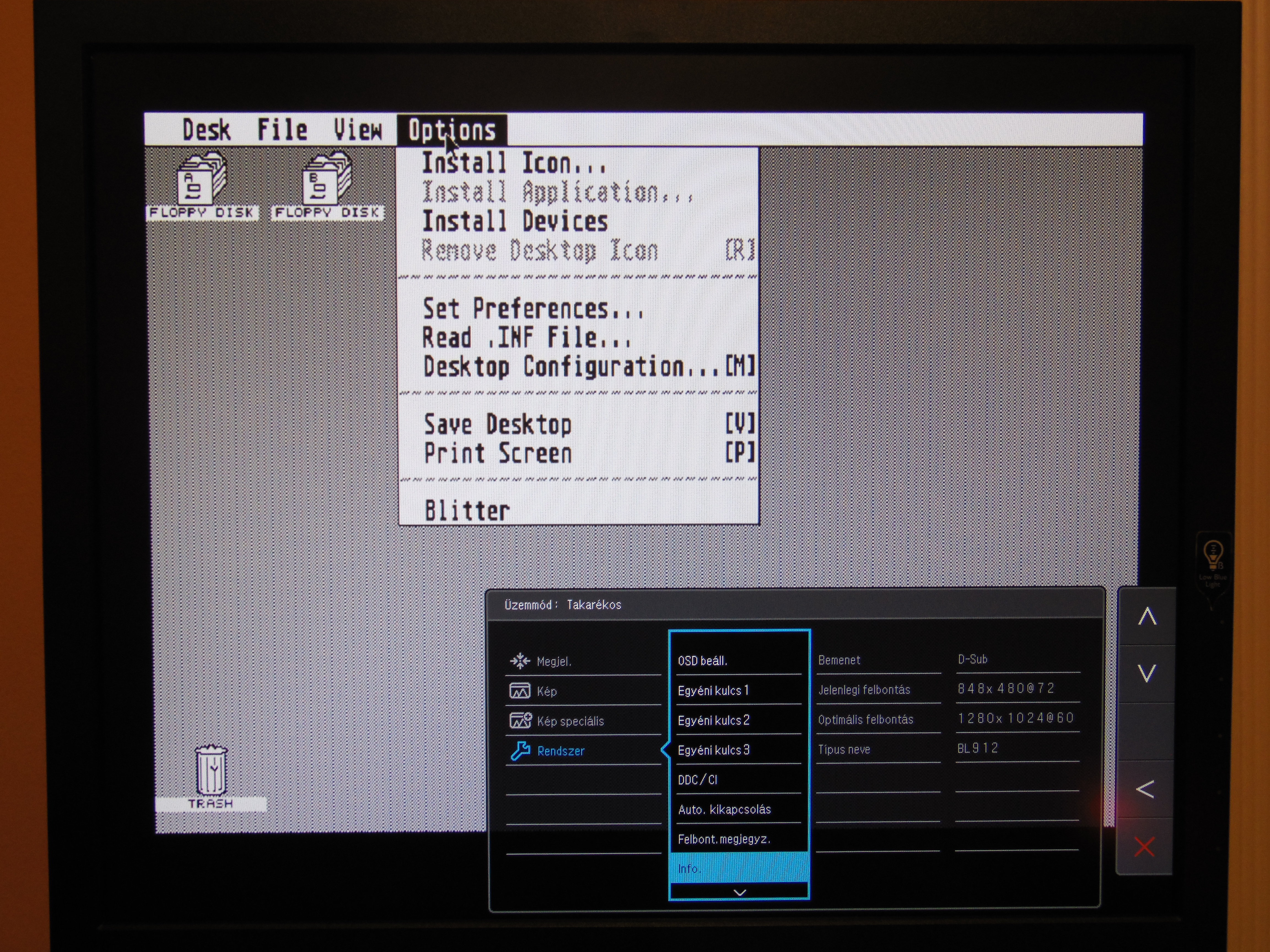

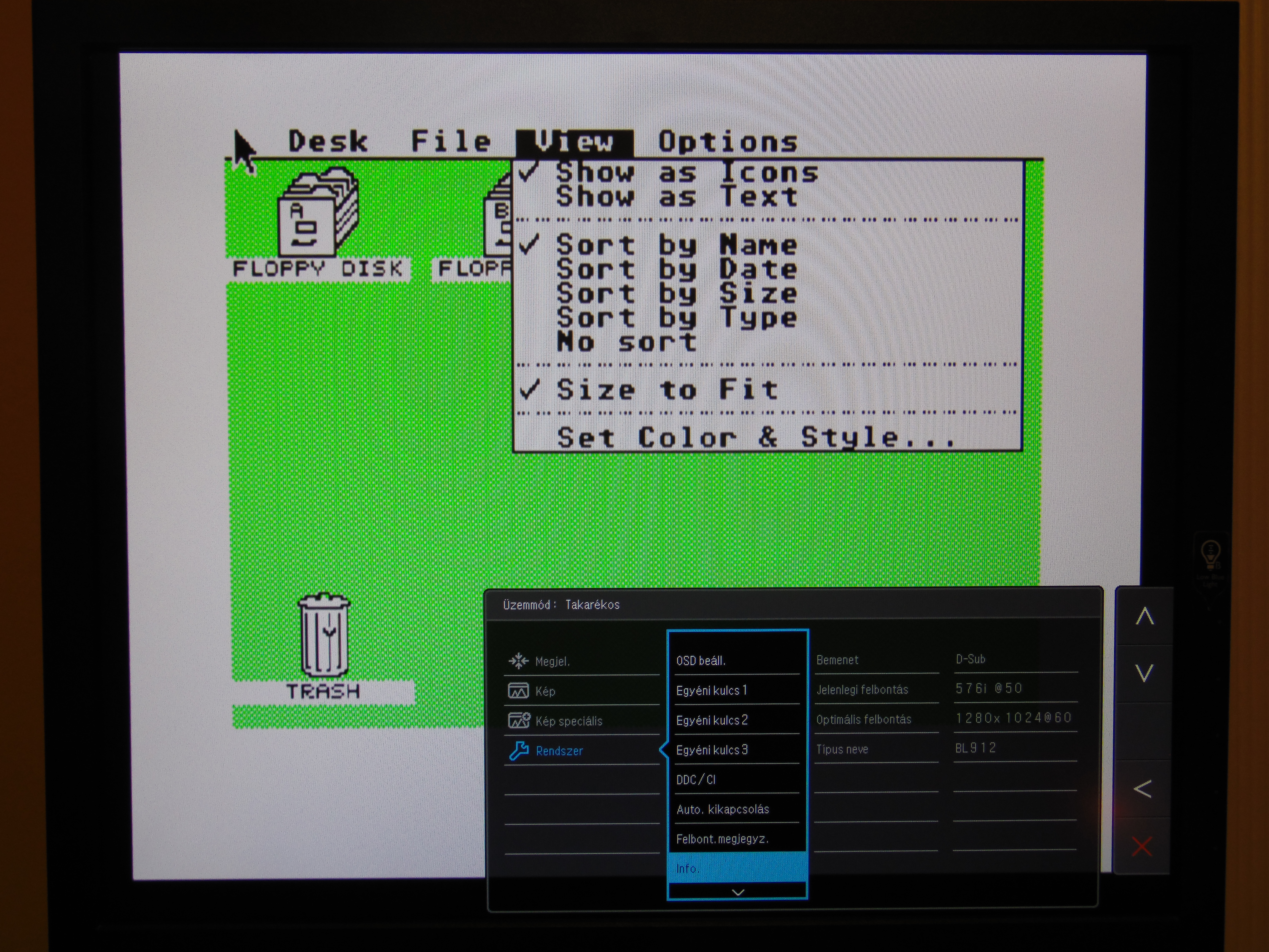

Postby DrOG » Tue Jun 13, 2017 4:15 am

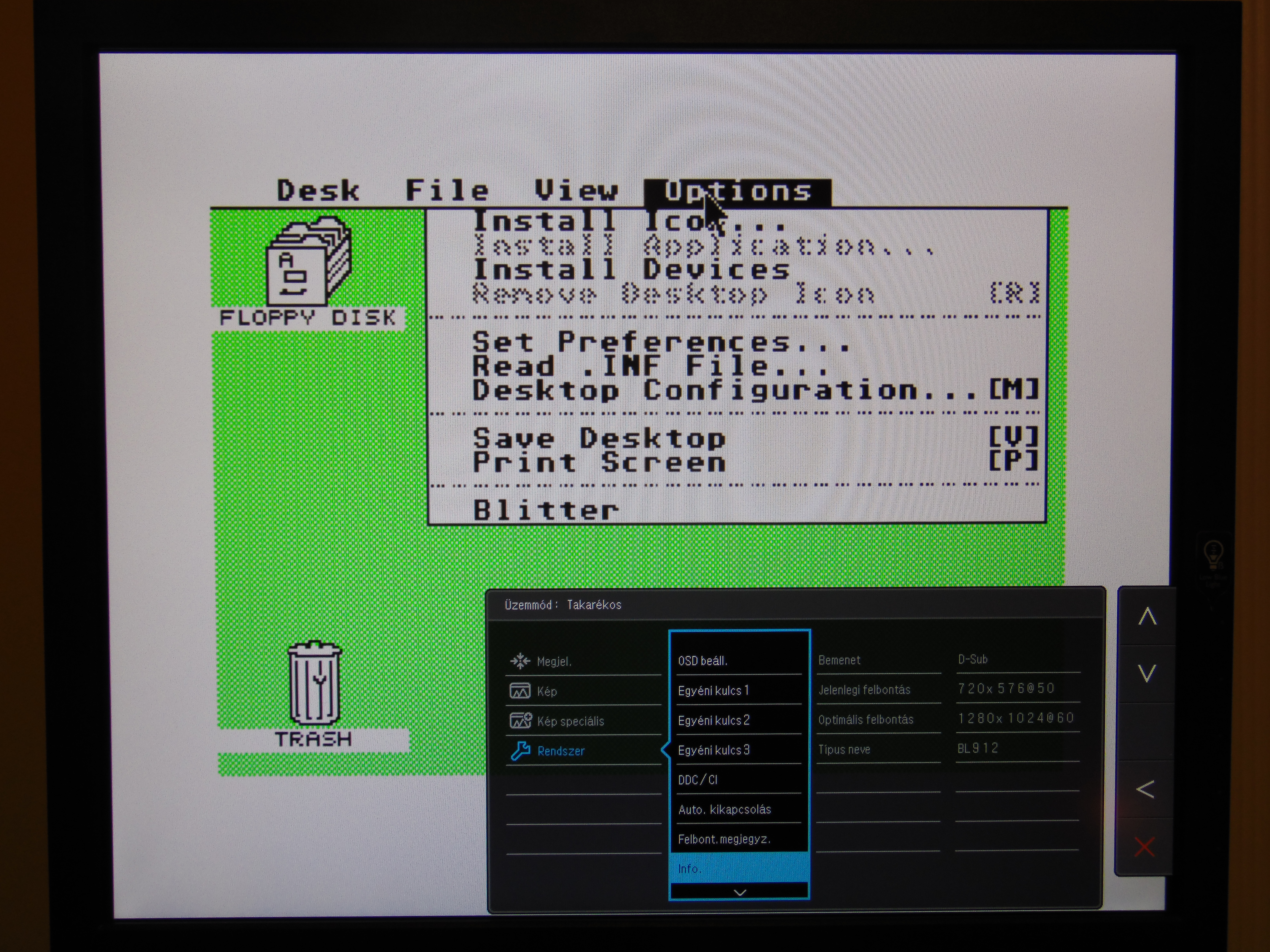

My results with the BenQ BL219 (used only the 'auto' option, didn't set the geometry of picture manually):
50Hz VGA:
Ugly scaling, but no borders.
56Hz VGA:
Ugly scaling with a narrow black stripe at the top & bottom of the screen.
Mono VGA:
Ugly, but perhaps somewhat better scaling, black borders around the picture.
50Hz SCART
A bit blurry image (interlaced signal!) with black borders around it.
I agree with eeun, the best solution is a CRT monitor! You can try older CRT TVs with minimig-to-scart cable also, perhaps this would be the most authentic way...

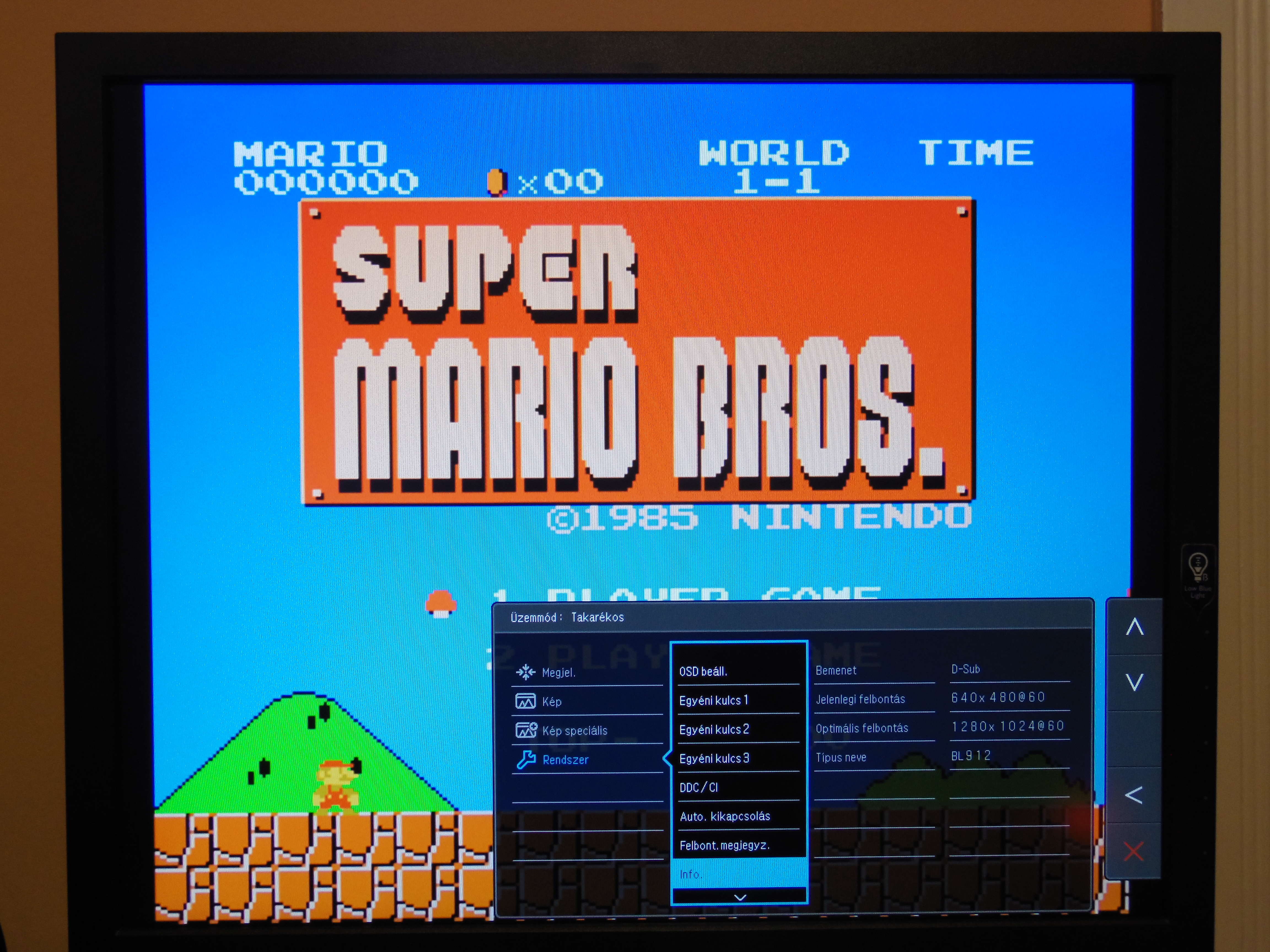

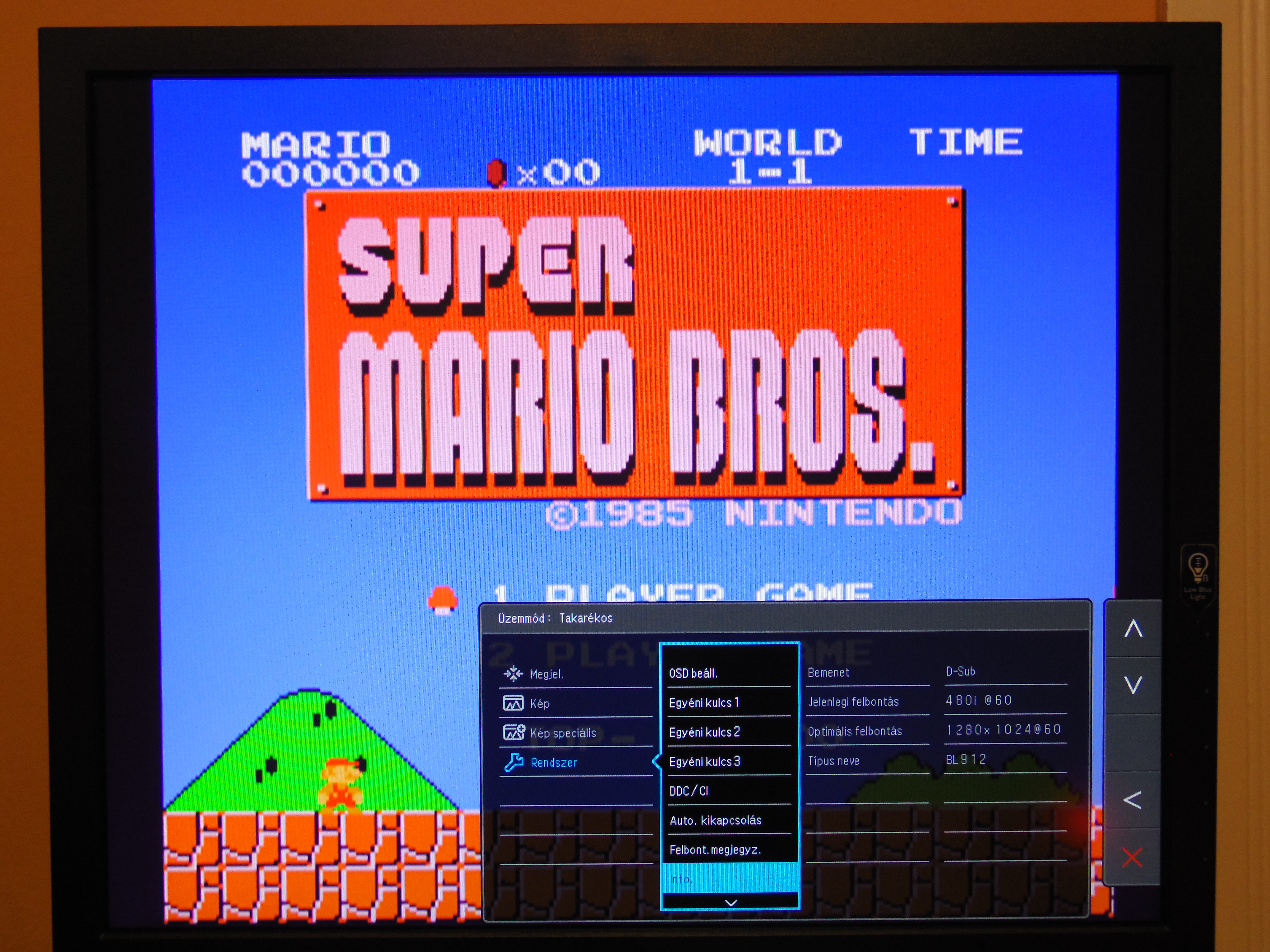

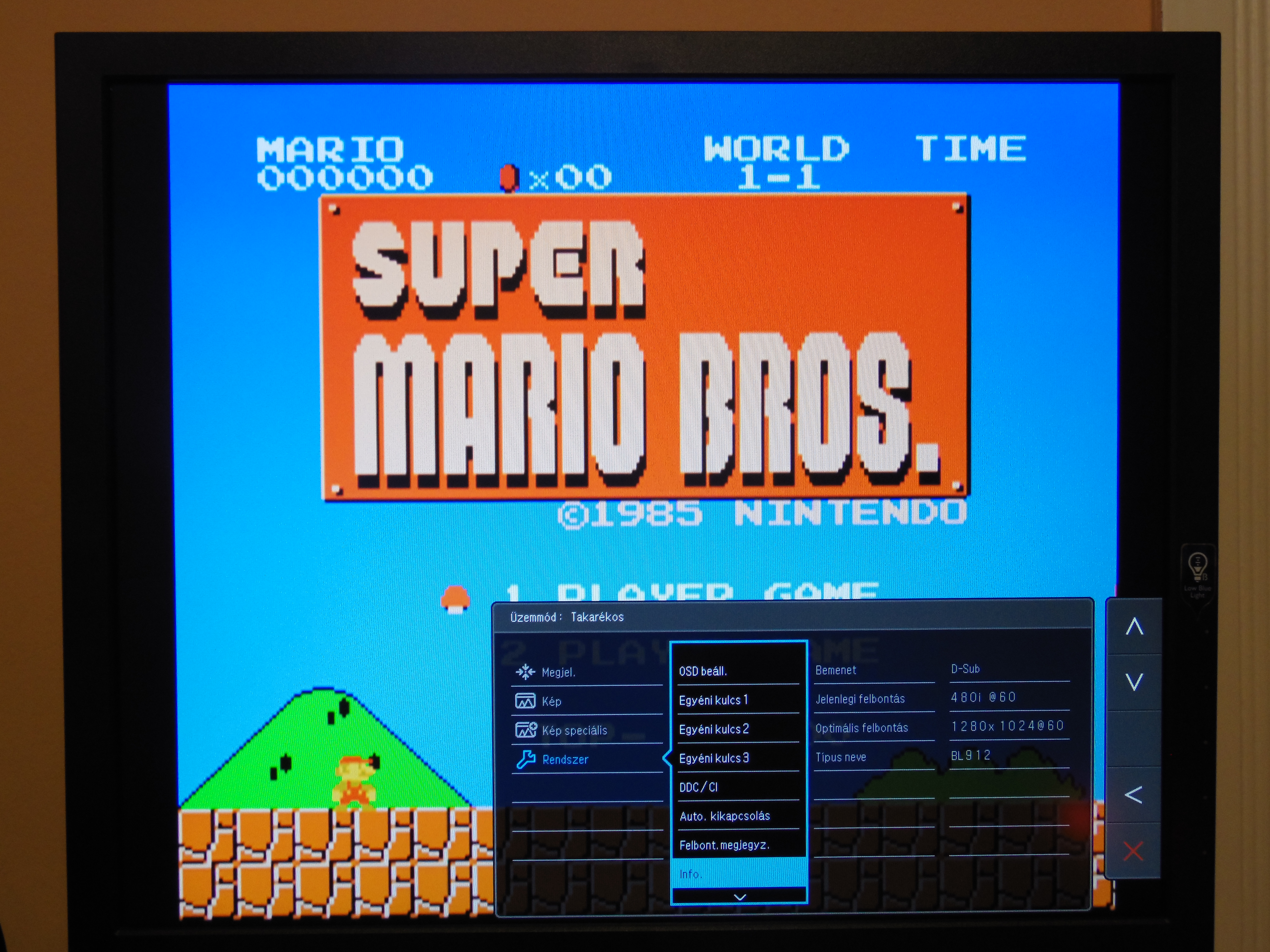

Hi All!
Yesterday I tested the NES core on my monitor for three reasons:
1. It's known to be problematic: has a badly (very left) centered image on most screens.
2. It's an NTSC core - tested only PAL sources so far.
3. It supports YPbPr/YUV output over VGA connector, thanks to Sorgelig!
It supports interlaced mode (scandoubler_disable=1) as well.
During my tests I used a standard VGA cable to connect the MIST to my BenQ BL912.
I used only 'auto' option, and didn't modify the picture's geometry manually.
I had to switch the colour format from RGB to YUV myself, because the monitor didn't identify it automatically.
Here are my results:
NES_VGA_progressive
NES_VGA_interlaced
NES_YUV_progressive
NES_YUV_interlaced
And the conclusions in some words:
1. There are black stripes on the left and right sides of the picture. These are wider in case of interlaced signal source.
2. The picture is well-centered.
3. The image is a bit blurry if scandoubler is disabled (we already knew that).
4. The white balance is not exactly the same: the picture is a bit reddish using YPbPr compared to RGB.

I tested consequently all the cores avaiable on the MIST with my BenQ BL912, and made some conclusions:
1. This display is (almost) omnivorous: the only core which exceeded it's abilities was the ZX01. Black screen in scandoubler enabled and disabled mode as well. My old Belinea CRT has glitches also when using this core, both in PAL and NTSC modes, on both sides near the top of the picture:
2. It tolerates low refresh rates well: although it's specification writes "Vertical input frequency: 55-76 Hz", works with much lower frequencies also:
-2 cores have 56Hz refresh rates: Atari ST in PAL 56 mode, and Videoton TVC VGA version, both works flawless (as far as I know this is the lowermost limit of standard VGA vertical frequencies, but i.e. my Samsung LE40B650 doesn't support it):
-Every PAL core has 50Hz output frequency (except Elektronika BK-0011M, which is only 49Hz - my LG L1734S refuses it, 'out of range'). The BenQ hasn't such problem.
-I found one very non-standard core, Gehstock's 'pacman(RGB Output Test#2).rbf', which uses 720x288@43Hz, and it's still fine for the monitor:
3. Sometimes it identifies incorrectly the colour format in 15KHz mode: only 2 cores are affected so far (SMS and MSX), and using my sync stripper with a composite out RGB device, there's the same issue. It's an annoying but manageable problem, since there's an option in the monitor's menu to change the color format manually from YUV to RGB.
4. Sometimes NTSC output is 640x500 instead of 640x480: the C64, PC Engine and Colecovision cores show this phenomenon:
5. It has not problem with unusual resolutions, manages well these absolutely non-standard values:
In case of Acorn Archimedes, during boot the messy red screen is 720x288@75Hz:
Desktop is usual 640x480@60Hz, but starting games it switches to 720x400@70Hz:
And in '64Hz Mono' mone (pressung key 2 on numpad during boot) it's 1600x900@65Hz:
The Amstrad has an extraordinary 73Hz refresh rate at 800x600 resolution (72 or 75 Hz would be standard):
Some arcade cores are affected also: Donkey Kong, 640x500@62Hz (it has several graphic glitches also):
And finally some nice interlaced 'solutions' (in these cases there might be a sync issue, as the cores below are not compatible with standard minimig-VGA-to-scart cable, and their resolution is 720x2??@??Hz. I think these are not real interlaced, but instead progressive signals with the half of the height?):
TRS-80(L2)-720x288@60Hz:
FPGAPCE-720x240@59Hz (It's an interesting case, as it has an original and a modded version, the latter is more compatible, but still not 100% perfect, and has issues with several screens):
And see the earlier mentioned Gehstock's 'pacman(RGB Output Test#2).rbf' also.
In normal case the monitor would indicate only the number of lines, the 'i' as interlaced and finally the refresh rate, i.e. 480i60/576i@50, see the Atari ST PAL mode for reference:
That's all so far.
I hope my experiences will help to developers correcting bugs and purchasers who are looking for a compatible monitor (you can pick up the non-standard cores to an SD-card and go for shopping equipped with the MIST, testing the display before buying it).
Regards: Gábor
